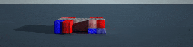

Such as material cutting:

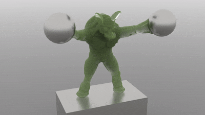

Two-way coupling of rigid bodies:

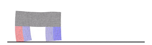

The first example is a differentiable elastic object simulator. After our actual measurement, it can also run on the 2017 version of the 13-inch MacBook Pro, and it takes less than ten minutes to complete the optimization:

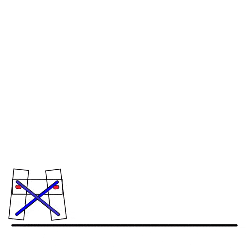

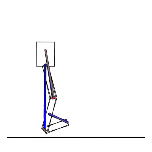

In the simulation environment of reinforcement learning, rigid body robots are common, DiffTaichi can also simulate:

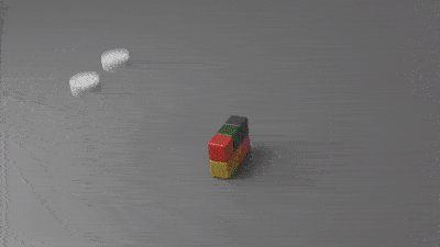

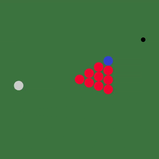

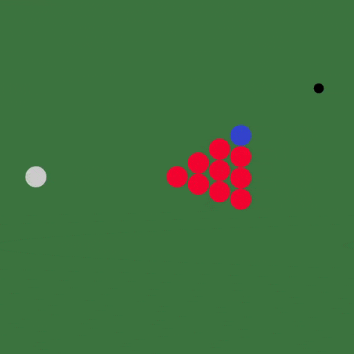

DiffTaichi can also simulate complex scenes with multiple objects, such as billiards:
