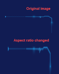

Normally, developers would insert an image as the border of components in dashboards.
But in the case where significant differences exist between the aspect ratios of components and border assets, the border will be incorrectly displayed.
The border is distorted
There’s no doubt that the management won’t be satisfied to see such things on the large screen dashboards, and it seems that there’s nothing can be done with it.

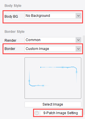

  • Component background filling and border can be configured individually.
  • With the image inserted via “Border”, you can further set the “9-Patch Image Setting” to keep the pattern exfactly the same.

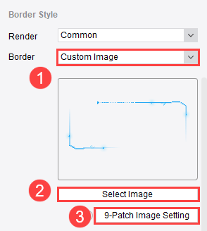

First, select a component and insert an image in “Border” on the attribute pane, then click on “9-Patch Image Setting”.
How to set 9-Patch

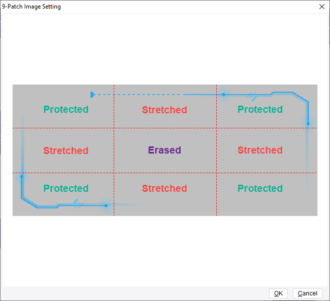

An interactive panel will show.
Here you can drag the lines to set protected areas.
The protected areas on the 4 corners will be kept the same when adjusting the size of components, while the 4 sides stretched.
How every patches are processed

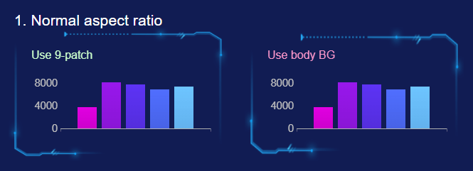

In cases where the aspect ratio of components is nearly the same as image materials, the filling effect of “Body BG” and “9-Patch” will look the same.
When the component is displayed in normal aspect ratio

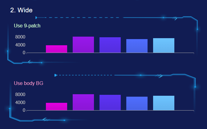

But when the aspect ratios differ greatly, “9-Patch” will have its benefit shown.
For example, the vertical sides of image-filled borders will look unusually thick (as you can see in the red box below) when the component is relatively wide.
“9-Patch” will help you avoid such issues:
When the component is wide

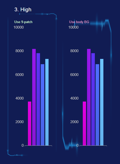

And it works better when the component is higher.
As you can see, the pattern on the top right corner distorted and blurred significantly, which impacted the overall feel of the component.
“9-Patch”, on the other hand, presented the patterns perfectly.
When the component is high
